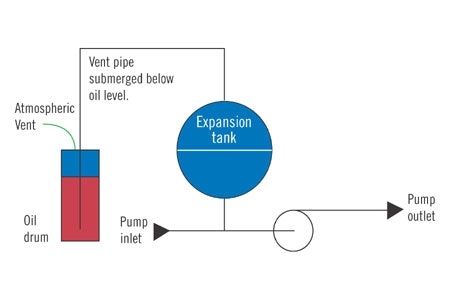

To prevent heat-transfer fluid oxidation, chemical facilities can use nitrogen as an inert barrier in the expansion tank (Fig. 1) or can use a cold-seal venting configuration on the tank (Fig. 2). These two methods will prevent the heat-transfer fluid from contacting atmospheric air through the expansion tank.

Cold-seal venting is a cost-effective alternative to nitrogen blanketing. However, in cases in which the heat-transfer fluid has a foul odor or undesirable fumes, nitrogen blanketing is advisable. In addition, some insurance carriers might prefer the use of nitrogen blanketing over cold-seal venting for fire protection purposes. Moreover, several commercially available heat-transfer fluids are considered hazardous fluids after being circulated through a heating system. For these types of fluids, the oil supplier probably will recommend nitrogen blanketing over cold-seal venting.

Figure 2. A Means for Escape
Cold-seal venting configurations provide a cost-effective alternative to nitrogen blanketing when vapors from the heat-transfer medium are not hazardous or undesirable.
