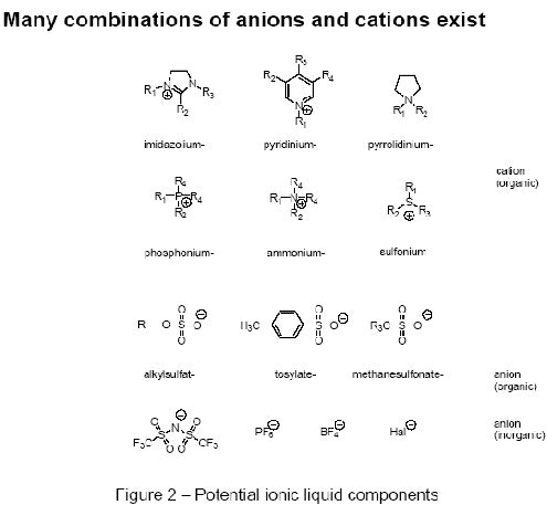

There are about 1018 theoretical combinations of cations and anions that could potentially form ionic liquids. A realistic number is much lower. Approximately 1,000 ionic liquids are described in the literature today; perhaps 300 are available commercially. Figure 2 shows typical structures that combine organic cations with inorganic or organic anions.
Creating combinations of organic cations and anions enables chemists to design, fine-tune and tailor ionic liquids to possess the physical and chemical properties that they need for their specific application.
