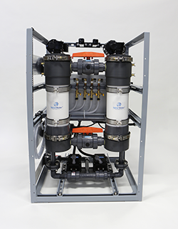

Spiral Water Technologies, Inc. offers two high solids water filtration skids with its Model 810 automatic, self-cleaning filter. The FS1 and FS2 skids – with one and two Model 810 filters respectively – are designed to address the problem of high and variable suspended solids removal. Delivering flows of up to either 75 or 150 gallons per minute, the FS1 and FS2 Skids remove ultra high and variable TSS of up to 25,000 mg/L, as well as oil and grease, in just one pass, according to the company.
The design of the Model 810 filters up to 100 times dirtier water, providing continuous 10 to 100 micron filtration with 10% energy usage, according to the company. The technology for automatic, self-cleaning water filtration reportedly reduces both CapEx and OpEx with 99% water recovery.
The compact and modular FS1 and FS2 Skids include an epoxy-coated steel support frame, pipe manifolds and programmable electronics to control filter performance and purge timing. The systems can be configured to operate on pump feed, gravity feed or pump suction. Purge valves are available in manual, electric and air actuated styles, and can be configured for high water recover or constant bypass.
