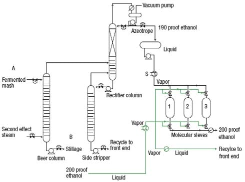

The distillation and dehydration operations consist of three columns and a parallel grouping of molecular sieves (Figure 1).
Figure 1. Three columns followed by a bank of three molecular sieves produce high purity ethanol.
The distillation system is fed with the fermentation process product, a mash that contains 10% to 14% alcohol, water and all non-fermentable solids from the corn and yeast cells (A). The first column, called the beer column, splits the mash into 190-proof (95 vol. %) alcohol and a residue mash called stillage (B). Whole stillage is transferred from the base of the beer column to the co-product processing area. The alcohol goes to a second column or rectifier. The bottoms from the rectifier pass to a side-stripper column — it sends alcohol back to the rectifier, while its bottom stream is recycled to the liquefaction process to reduce heat consumption.
Meanwhile, overhead from the rectifier goes to the dehydration step to yield product that exceeds 99 vol. % alcohol. Without that final drying process, the ethanol produced by fermentation wouldn’t be a viable fuel.
BSE’s dehydration process consists of three vessels, each containing Type 3A zeolite beads, which require regeneration. The units cycle through a sequence of in service, ready and regeneration.
Pressurized, superheated 190-proof alcohol from the distillation system is fed into one of the vessels. Water is exothermically adsorbed on the beads while ethanol passes through the bed. When the beads near full loading, the feed alcohol is diverted to a second vessel ready to take over. The anhydrous ethanol vapor goes to the process for heat recovery, is cooled back to a liquid and sent to storage tanks. Meanwhile, the molecular sieves in the first vessel are regenerated, removing the water by adding energy with recycled product.

The application for the distillation system controls the production rate and quality of the 190-proof product that goes to the sieves. It also keeps the pressure and temperature constraints within the limits to avoid flooding and reduces ethanol losses. Table 1 lists some of the control components for the distillation process.
Table 1. The application predicts changes in controlled variables to moves in manipulated variables and corrects as necessary.
In addition to controlling the differential temperature and pressure in the three columns, the application contains virtual online analyzers for the amount of ethanol in the bottoms of the beer and side stripper columns. The controller also includes models for measured disturbances such as beer feed and hydroheater temperature (e.g., waste heat flashed to the side stripper column). The hydroheater temperature provides a prediction of steam changes going to the side stripper column from the cook flash tank.
Anhydrous alcohol quality control is the most important objective for the molecular sieves. The MPC application controls total ethanol production rate and end product quality by manipulating the sieve pressure and feed flow rate. The controller includes disturbance models for feed composition and temperature. Besides 190-proof flow rate and composition, distillation and sieves variables are linked through the 190-proof tank level.
