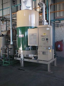

A third type of boiler, technically a forced-circulation water tube boiler but commonly referred to as a steam generator, uses a mechanical water pump to control and circulate the internal water flow (Figure 1). Tubes normally are configured in a coil shape, so such units often are called "coil type" boilers.
