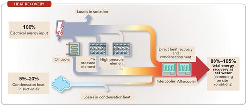

Manufacturers face more-stringent mandates to restrict carbon dioxide emissions. Recovering the heat byproduct of compressed air is one step process plants can take to help reduce CO2 emissions and the risk of penalties for failing to meet emerging environmental standards. Doing so also will decrease total lifecycle cost.
In air compression, the electrical energy used to compress air is transformed into heat. However, it isn’t the only source of energy during air compression. Another important source is the humidity contained in the air entering the compressor inlet. Following compression, this humidity is condensed into liquid as the air is cooled in the intercooler and aftercooler. In the process of cooling this air, the latent heat of condensation is released into the cooling water. (The amount of latent heat of condensation depends upon the temperature and relative humidity of the intake air.)
The process of compressing the air includes several instances where heat is generated and transferred to the cooling water system. Some of the heat of compression passes to the cooling water around the compression elements via the element cooling jackets; a significant amount of heat is released to the coolers’ cooling water system. Additionally, the heat removed from the hot oil in the oil cooler is discharged into the cooling water system.
[callToAction]
The percentage of recoverable electical energy depends upon the compressor’s operating conditions. Intake air temperature, relative humidity, water temperature and pressure all play a role.
Some energy is lost through motor inefficiencies, via radiation of components such as the element and the cooler, and in residual heat and heat of condensation remaining in the outlet air.
Heat Recovery
Figure 1. Compression system suffers some minor energy losses but the vast majority of heat is recoverable.
If we combine all these factors in an overall view (Figure 1), the net result is that, for typical industrial conditions, we can recover 90–95% of the electrical input energy. And in specific conditions, recovering more than 95% is possible. An energy recovery system uses this energy to produce hot water.
