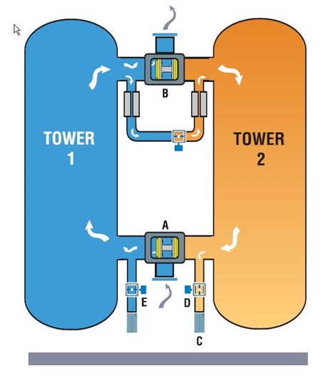

The heatless desiccant dryer (Figure 1) is the most common style of unit in compressed air systems that require dew points at less than 35°F. Such a dryer can be a costly energy hog because it gulps down expensive compressed air just to keep operating. A purge of compressed air must flow in this dryer to reactivate the desiccant once it becomes saturated.
Heatless Desiccant Dryer
Figure 1. The unit is a fairly complex pneumatic device with a significant number of valves and fittings. Source: Compressed Air Challenge.
A – Inlet valve
B – Outlet valve
C – Exhaust valve and muffler
D – Exhaust valve and muffler
E – Bypass valve to control purge flow
