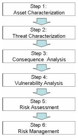

The CSAT-SVA is a six-step process (see Figure 2) that links the output from the Top-Screen and general site attractiveness to specific assets, allowing more-focused consequence analysis and risk assessment, and providing a baseline for security countermeasures that will be articulated in the SSP.
Figure 2. The SCAT-SVA’s six steps lead to an assessment tailored to the site.
It documents the process of identifying security vulnerabilities and provides methods to evaluate the options for addressing those weaknesses using example countermeasures identified in the SSP Security Countermeasure Database.
The CSAT-SVA is used to further characterize the facility, determine plausible worst-case scenarios assuming successful attacks on critical assets, and evaluate vulnerability. A standardized set of potential terrorist attack scenarios and assumptions allows for cross comparison of chemical facilities and the determination of vulnerability on a common scale.
DHS’s presumptive tiering is based on the potential consequences that could be generated following a successful attack or due to the presence of types of chemicals at the facility. (The final threshold values that DHS will use for tier cutoff levels will be classified.) The Department will determine the final tier level for the facility and for the critical assets within the facility based upon the SVA results and the previous Top-Screen information. A facility’s tier level will depend upon the highest tier determined for all of its critical assets.
