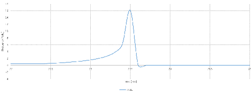

True Values
Figure 1. Data show that pressure spike reached about 16 psig.

Signal processing really comes down to how many points we get, how accurate they are and what we do with the space in between them. The way data are reported can have important consequences. Let’s illustrate this with three graphs of an event — first the true values, then the averages, and finally the maximum values.
Figure 1 shows the true pressure values for a system measured over a period of time. In this case, the data yield a mathematical function that increases quickly over a second. The graph plots ten data points per second.
