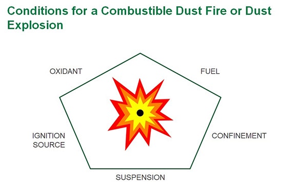

Dust Explosion Pentagon
Figure 1. An effective mechanical integrity program can prevent conditions that can lead to an explosion.
This article outlines an effective approach to addressing combustible dust hazards by implementing a proactive and robust mechanical integrity (MI) program.
