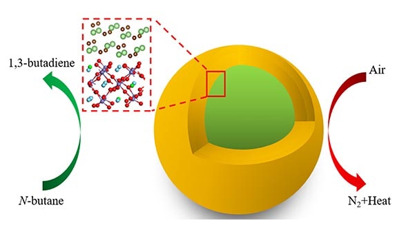

So, to make butadiene production facilities more commercially viable, the researchers engineered a lithium bromide (LiBr) shell catalyst surrounding a core of lanthanum strontium ferrite (Figure 1). Using a modular reactor, an oxidative dehydrogenation reaction run at 450°C to 500°C converts more butane into butadiene with each pass through the reactor than achieved with previous catalysts, they report.
