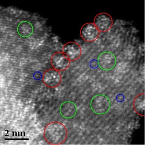

Providing the right surface coverage of sub-nanometer clusters of tungsten oxide on a zirconium oxide support (Figure 1) makes the catalyst five times more reactive for n-pentane isomerization, reports an international group of researchers. And the strategy promises to bolster a variety of other acidic reactions, says Michael Wong, a professor at Rice University, Houston, a part of the team.

Figure 1. An atomic-level image of tungsten oxide nanoparticles (green circles) on zirconia support. The other circles show the less-active forms of tungsten oxide. Source: Wu Zhou/Lehigh University
He says now that the catalyst formula is "just right."
