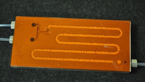

Figure 1. Narrow zigzag channel containing catalyst-covered beads enables precise control of temperature and reaction time for polymerization. Source: Kundu, NIST.
The team from the National Institute of Standards and Technology (NIST), Gaithersburg, Md., and the Polytechnic Institute of New York University, Brooklyn, N.Y., converted ε-caprolactone to polycaprolactone. This polymerization usually relies on an organic tin-based catalyst that is toxic; the researchers instead opted for a benign enzyme made by yeast. They used a microreactor consisting of an about 40 mm × 90 mm 10-mm-thick aluminum plate containing a zigzag channel 2-mm wide × 1-mm deep filled with catalyst-covered beads (Figure 1). The beads were loaded by applying a vacuum at the end of the channel. More details appear in a recent article in the Journal of the American Chemical Society.
