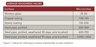

The surface condition of the inside wall of a pipe also impacts flow efficiency. In a commercially manufactured pipe this wall isn't smooth (Figure 1). The degree of surface roughness is a function of the pipe material, method of descaling and environment to which it has been exposed. In turbulent flow the surface roughness affects the friction factor and, thus, the pressure gradient in the pipe.
AVERAGE ROUGHNESS VALUES
Figure 1. Values for steel pipe increase substantially as pipe weathers.
Over time, scale and deposits may form, impeding flow — reducing throughput, stressing equipment and increasing the probability of unscheduled downtime.
