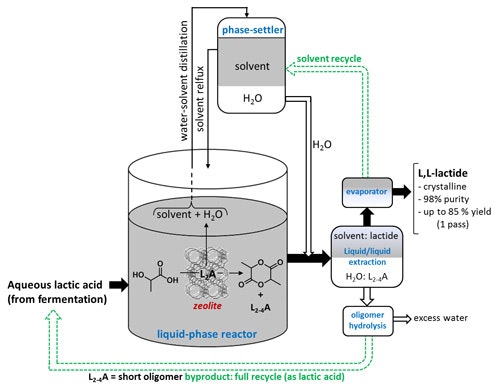

A single-step process outperforms the current two-step route for making lactide, a key precursor of polylactic acid (PLA), a popular biodegradable polymer, say researchers at the Center for Surface Chemistry and Catalysis, KU Leuven, Heverlee, Belgium. The zeolite-catalyzed method not only eliminates the cost and complexity of a second step but also reduces byproduct formation, they add. “Products made of PLA now can become cheaper and greener,” enthuses Bert Sels, a professor at the Center and head of the team that developed the process.
Lactide Process
Figure 1. Single-step method promises technical and economic advantages. Source: KU Leuven.
In the route, aqueous lactic acid produced via fermentation goes to a stirred-tank reactor where a highly selective zeolite catalyst converts it into lactide at yields of up to 85% in a single pass (Figure 1). The process relies on a commercial zeolite, H-Beta, that has shown stability and reusability over several consecutive runs of the process. More details appear in a recent article in Science.
