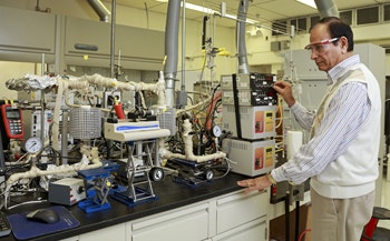

Figure 1. Chaitanya Narula led analysis of an ORNL biofuel-to-hydrocarbon conversion technology to explain the underlying process. Source: ORNL.
The researchers’ analysis found that this energy-consuming intermediary step isn’t necessary for conversion. Instead, an energy-producing “hydrocarbon pool” mechanism allows the zeolite catalysts to directly produce longer hydrocarbon chains from the original alcohols.
“It challenges a long-held, but incorrect, assumption,” notes ORNL co-author Chaitanya Narula. “It has been assumed that you must go from ethanol to ethylene, which is endothermic and requires energy. We showed this step doesn’t occur, and that the overall reaction is slightly exothermic.”
ORNL researchers tracked the molecular transition in labeling experiments with deuterium to confirm the hydrocarbon pool mechanism. They used a versatile heterobimetallic catalyst that completely converts ethanol to hydrocarbons at 250–450°C and atmospheric pressure without added hydrogen. The catalyst exhibits superior performance compared to monometallic catalysts as determined by low C2 yield and high durability.
“Our method of direct conversion of ethanol offers a pathway to produce suitable hydrocarbon blend-stock that may be blended at a refinery to yield fuels such as gasoline, diesel and jet fuel or commodity chemicals,” Narula explains.
