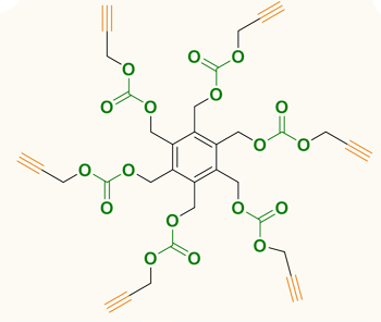

Star-Shaped Molecule
Figure 1. Carbon dioxide serves as feedstock for producing six-arm star-shaped compounds. Source: Agency for Science, Technology and Research, Singapore.
The compounds produced by the team contain a benzene ring with either three or six identical arms, each terminated with a 1-alkynyl group. Synthesis involved reacting tri- or hexa-bromomethyl benzene and propargyl alcohol at room temperature under CO2 at atmospheric pressure with tetrabutylammonium bromide as a promoter. The synthesis took two days for the three-arm compound and four days for the six-arm one; yields were 71% and 65%, respectively. More details appear in an article in Chemical Communications.
