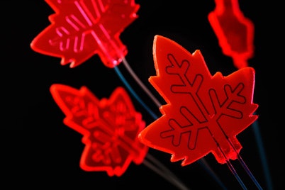

Figure 1. The amount of light captured by the microphotoreactors is visible, lit up bright red. As liquid is pumped through thin channels or “veins” in the leaves, light causes the reactions. Source: Bart van Overbeeke.
