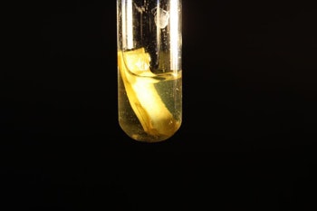

The technique involves immersing biomass (without any preprocessing) in an alkaline aqueous solution containing semiconducting cadmium sulfide quantum dots and then exposing the system to sunlight (Figure 1). The resulting reactions produce hydrogen and organic chemicals such as formic acid and carbonate from cellulose, hemicellulose and lignin, explain the researchers. The hydrogen is free of materials such as carbon monoxide that would inhibit its use in fuel cells, they add.

Figure 1. Paper immersed in aqueous solution containing cadmium sulfide quantum dots breaks down to form hydrogen when exposed to sunlight. Source: Cambridge University.
