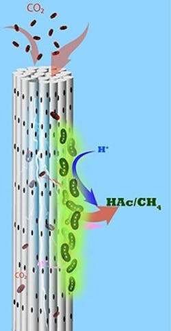

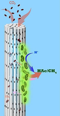

So, the team developed an alternative MES reactor using cathodes made from stackable, cylindrical porous nickel fibers that Saikaly’s group previously applied to recover water and energy from wastewater. Here, CO2 is pumped through each cylinder, and electrons flow along it.
“Using this architecture, we directly deliver CO2 gas to chemolithoautotrophs through the pores in the hollow fibers,” Alqahtani explains. “We provided electrons and CO2 simultaneously to chemolithoautotrophs on the cathode surface.”
In Alqahtani’s initial study, the porous nickel hollow fibers act as an inorganic electrocatalyst for hydrogen generation from proton reduction and as a gas‐transfer membrane for direct CO2 delivery to CO2‐fixing hydrogenotrophic methanogens (biological catalysts) on the cathode. These novel features create a suitable environment for the enrichment of methanogens, which utilize the hydrogen as a source of reducing equivalents for converting CO2 to methane.
Kaust Microbes
Caption: Microbes growing on porous cylindrical electrodes suck in CO2 and turn it into useful chemicals such as acetate and methane. Source: Bin Bian/KAUST.
