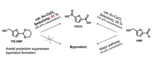

Reaction Pathways
Figure 1. New route acetalizes HMF to suppress the formation of unwanted humins. Source: Hokkaido University/Eindhoven University of Technology.
To achieve this, the team first acetalizes HMF with 1,3-propanediol (1,3-PD) to block byproduct-inducing formyl groups (Figure 1). This HMF-acetal derivative exhibits excellent thermal stability and its oxidation with a CeO2‐supported Au catalyst and Na2CO3 in water gives a 90–95% yield of FDCA, the researchers report.
About 80% of the 1,3-DP employed to protect the formyl groups can be reused for subsequent reactions.
