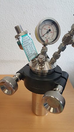

The method developed by Frank Glorius, a professor of organic chemistry at the Westfälische Wilhelms-Universität in Münster, and his team requires two consecutive steps — but in the same reaction vessel and using a single catalyst. The researchers produce the active ingredients in a 170-ml vessel operating at 50 bar hydrogen at 25–40°C.
The first step involves the dearomatization of easily accessible, chemically inert fluorinated pyridines. In the second step, a hydrogenation reaction transfers hydrogen atoms to one side of the pyridine ring system.
“This dearomatization-hydrogenation sequence is a one-pot process that doesn’t require the isolation or purification of the intermediates. We simply mix all reagents together and then set the vessel at the required pressure of hydrogen,” explains Glorius.
