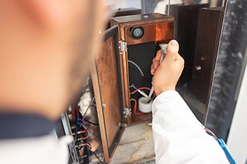

To do this, the team allows a particle to catalyze oxygen generation on the surface of the electrode and then measures the current flow. This, in turn, provides information about the reaction rate (Figure 1). “We have measured current densities of several kiloamps per square meter,” says Tschulik. “This is above the reaction rates currently possible in industry.”
Reaction Rate Testing
Figure 1. Researchers use a shielded cell to assess nanoparticles in electrochemical experiments. Source: RUB/Kramer.
