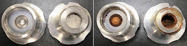

Figure 1. Initial components are placed in steel jar (left) to which a steel ball is added, and then undergo vigorous shaking, resulting in reaction products (right). Source: Kubota, K. et al. Science, December 19, 2019.
