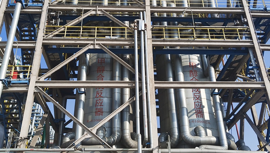

China Energy Corp. is the largest coal-to-chemicals company globally. It owns and operates a world-class coal-to-liquids plant in Yinchuan, Ningxia Province (Ningxia Coal Industry Co. Ltd., NCIC), that produces methanol that serves as feedstock for the company’s methanol-to-propylene (MTP) unit. However, methanol supply had not kept up with its demands. The company needed a reliable way to quickly improve productivity and decided to upgrade to the MegaMax 800 methanol synthesis catalyst (Figure 1). NCIC selected the new catalyst because of its higher activity, which was expected to increase methanol yield with no rise in feedstock consumption, and improve overall productivity of both the methanol and downstream MTP plants.

Figure 1. New catalyst is delivering higher productivity and selectivity for Chinese producer.
Clariant developed the MegaMax 800 catalyst specifically to provide higher activity, up to 40% better than previous catalyst generations, and superior selectivity towards methanol production — even at very low reactor temperatures and pressures. Depending on the facility’s design and processes, a producer can expect to increase methanol capacity by as much as 10%. This results in greater carbon efficiency and methanol yield while reducing synthesis gas consumption. Moreover, the catalyst is exceptionally robust, easily tolerating demanding daily operation and protecting against process upsets.

Loaded and started-up at the NCIC plant in August 2018, the new catalyst achieved an anticipated operation load of 102% after just two months. Even though it currently is running at variable capacity, the 1-million-ton/yr methanol plant is experiencing considerably higher yield at lower energy and feedstock costs. Compared to operation with the previous catalyst, synthesis gas feedstock consumption has decreased by 40 million m3/yr. Assuming a unit cost of 0.4 RMB/m3, the plant annually should save around RMB 16 million (approximately $2.3 million).
The facility also is reporting noticeably lower formation of byproducts such as ethanol in the crude methanol product. This reduces steam consumption for the downstream distillation unit and, thus, adds to the plant’s total profitability. Based upon its 1-million-ton/yr design capacity, the methanol unit likely will save 238,000 tons of steam annually, which equals RMB 6.73 million (nearly $1 million) in financial value to the company. Following the successful installation of the catalyst, Clariant also recommended reducing the steam drum pressure from 2.2 to 1.85 MPa, allowing the plant to benefit from the catalyst’s low temperature activity at constant feedstock consumption.
