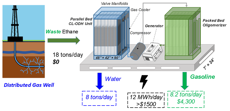

Molten Carbonate Catalyst
Figure 1. The image shows the reaction pathways for oxidative dehydrogenation of ethane facilitated by the molten carbonate shell modified perovskite redox catalyst. Source: Fanxing Li/North Carolina State University.
