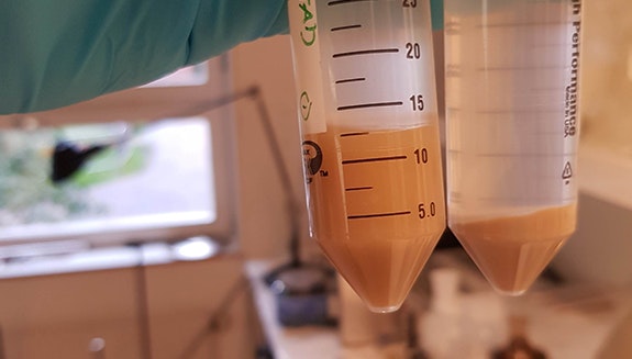

In a recent issue of Advanced Sustainable Systems, researchers from the KTH Royal Institute of Technology, Stockholm, Sweden; the SLU Swedish University of Agricultural Sciences, Uppsala, Sweden; and Kyoto University, Kyoto, Japan, describe the synthesis of superabsorbent particles from nontoxic WG protein: a natural molecular cross-linker named genipin (a hydrogenated glycoside extracted from the fruit of gardenia jasminoides), together with a dianhydride (ethylenediaminetetraacetic or EDTAD), generate a material with a network structure capable of swelling up to 4,000% in water and 600% in saline solution.
This represents a tenfold increase compared to the already highly absorbing gluten reference material (Figure 1). The carboxylation (using EDTAD) and the cross-linking of the protein result in a hydrogel with liquid retention capacity as high as 80% of the absorbed water remaining in the WG network on extensive centrifugation, which is higher than that of commercial fossil‐based SAPs.
