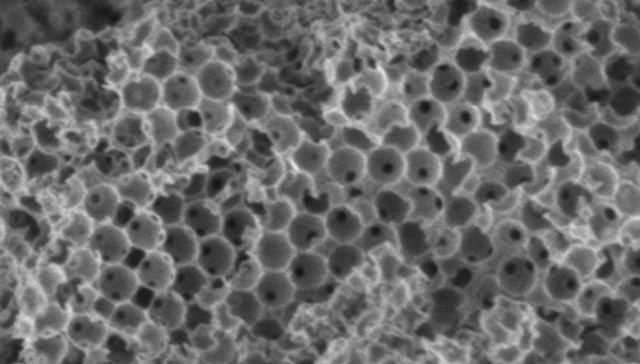

Figure 2. Sponge-like catalysts could transform biodiesel production and chemical manufacturing. This image shows the porous ceramic sponge fabricated in the study, magnified 20,000 times. Source: RMIT.

Lee’s team synthesized a micron-scale ceramic sponge with a hierarchically porous framework in which the macropores are selectively functionalized with a sulfated zirconia solid acid coating and the mesopores with magnesium oxide solid base nanoparticles. Molecules initially enter the sponge through large pores, where they undergo a first chemical reaction (transesterification) and then pass into smaller pores where a second (condensation) reaction occurs.
It’s the first time a multi-functional catalyst has been developed that can perform several chemical reactions in sequence within a single catalyst particle; it could be a game changer for the $34-billion global catalyst market, Lee believes.
