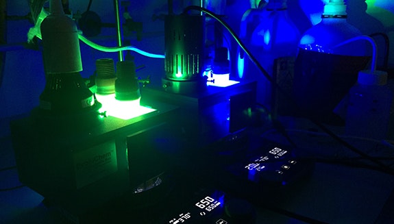

The current set-up uses a commercial system in which powerful LEDs shine onto a cooled coil of transparent tubing through which the reaction mixture flows (Figure 1).
“If we chose to, we could increase capacity further by using industrial photoreactors designed for production scale,” he concludes.
