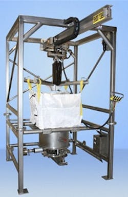

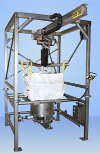

Low Headroom Bulk Bag Discharger
Material Transfer announces the sanitary Material Master bulk bag discharger
Material Transfer's sanitary Material Master bulk bag discharger is designed for Class I, Division I service under a 108-inch ceiling height. The system features sanitary 316L stainless steel construction with round horizontal tubes, no tube penetrations, welded stand-offs and continuous TIG welds for easy, thorough cleaning. The system also offers a Seal-Master bag spout chamber with gull wing doors for easy discharge spout access and a Sure-Seal actuated bag spout clamping system for dust-tight product discharge.
