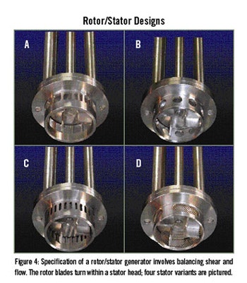

Rotor/stator HSM.
This unit uses a high-speed rotor/stator generator to apply intense mechanical and hydraulic shear. The blades of the rotor run at tip speeds of 3,000 to 4,000 fpm within a fixed stator. As the blades rotate past each opening in the stator, they shear particles and droplets, expelling material at high velocity into the surrounding mass. As material is expelled, more is drawn from beneath into the high-shear zone of the rotor/stator, promoting continuous flow and fast droplet/particle size reduction. Units are available in a variety of configurations (Figure 4). The large square-hole disintegrating head (a) suits applications that require extremely energetic flow. The disintegrating head (b) with large round holes works best for general purpose mixing. It generates vigorous flow and rapidly reduces the size of large particles. The slotted head (c) provides the most popular combination of high shear and efficient flow rate. It often is chosen for emulsions and medium viscosity materials. The fine screen head (d) gives the highest shear, but at the expense of a slower feed rate. It is most suitable for low-viscosity emulsions and fine dispersions.
This HSM's intense shear works well to reduce droplet or particle size for homogenization, dissolution, solubilization, emulsification, grinding and dispersion. Operating alone, the HSM is most suitable for mixing materials with a maximum viscosity of 10,000 cP. Used in tandem with the anchor, it can handle viscosities up to about 200,000 cP.

    In most mixing operations these days, the rule of thumb is to apply as much shear as possible without overstressing the batch with excessive shear or heat. This usually is the most direct way to accelerate the mix cycle. We can boost shear by:
  • Raising the speed of the high shear devices;
  • Reducing the tolerances between the rotor and stator; or
  • Switching to a stator design that is more restrictive. This increases mechanical and hydraulic shear, but decreases flow.
    In our test center, the impact of higher shear usually is observed in any of three ways: smaller particle/droplet sizes; more-uniform particle-size distribution; and faster cycle.
    In some circumstances, achieving just one of these improvements alone can provide significant benefit. For example, by adding a second disperser blade to a shaft, we certainly will boost the energy applied to the batch, but will not increase shear meaningfully or affect particle size markedly. We will stimulate greater circulation in the vessel and perhaps allow a faster cycle time than would be possible with only one disperser blade. A cycle time gain could lead to a valuable increase in per-batch production.
