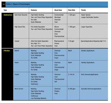

Types of units
Centrifuges fall into two main categories: sedimentary and filtration. Sedimentary machines include solid and screen bowl decanter, high-speed disc and tubular units. Filtration units include basket, peeler, pusher and worm screen (sometimes called oscillating worm screen). Special types and modifications of centrifuges are found in both major categories. Table 1 provides some broad selection guidance, and Table 2 details typical solids loadings in feed streams for units.
Despite the many types of centrifuges available, they share some common aspects. Feed always enters a rotating cylinder that is spinning on either a vertical or horizontal axis. Gravitational force produces the separation.
Centrifugal action forces particles or heavier liquids to the wall of the cylinder, while the lighter material, called the centrate, moves toward the center of the bowl where it can be removed. The action can be batch or continuous. Many units now are designed to be self-cleaning.
A continuous solid-bowl centrifuge consists of a cylindrical-conical solid bowl shell with an internal contoured scroll conveyor. The scroll rotates at a small differential speed to the bowl. The feed (often a slurry) enters through a hollow shaft in the helical conveyor and discharges into the pool inside the machine. The centrifugal forces exerted by the spinning unit move the heavier solids to the bowl wall. The difference in rotational speed between the bowl and the helical conveyor causes the solids to be moved along the bowl walls to the discharge port. The clarified liquid pools and overflows through a weir and exits at the large diameter of the bowl.
