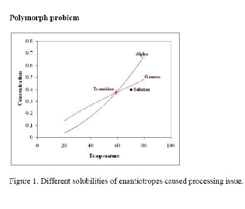

A very similar crystallization situation occurred at another plant. There, a large variation in filtration rate occurred, but it was never repeatable. Occasionally, the plant would get a “super” batch that filtered in half the normal time. This was a very desirable, but seemingly random outcome. That batch had a slightly larger and narrower PSD.
Examination of the particles under a microscope revealed that the habit was different. No polymorphs or solvates were known for this material — however, an evaluation of the chemical structure suggested at least four polymorphs and two solvates.
This led to a closer look at process conditions. The standard operating procedure called for cooling of the under-saturated solution until a heat flux was observed in the jacket of the vessel. The difference between the inlet temperature and the outlet temperature was used to mark this heat flux. The temperature was held constant for a fixed period of time and then the batch cooled to the final temperature at a constant rate. In the super batch case, this step-change in heat flux was not observed; cooling occurred below the normal holding temperature at which the heat flux usually was seen. There was no holding period and cooling continued to the final temperature.
What was really happening in the process got lost in translating the research work to the process development and operation. This material exhibited classic enantiotropic behavior: a transition temperature between two polymorphs (alpha and gamma) as shown in Figure 1. The gamma form is unstable and has lower solubility above the transition temperature while the alpha form has the lower solubility below the transition temperature.
The under-saturated solution at the starting temperature has a solute concentration below the solubility of gamma and alpha. As the temperature decreases, the gamma form comes out of solution and crosses the transition temperature. More crystallization occurs until the concentration is outside of the meta-stable limit for the alpha form. Rapid nucleation (the heat flux) of alpha begins and the gamma form begins to dissolve. At that point the rate of cooling is slowed but the damage has been done. The excessive amount of nuclei hinders growth and results in a wider and smaller PSD.The simple solution to this problem is to dilute the solution to below the concentration that corresponds to the transition temperature. If the volume of solvent that results is too large for the solid/liquid separation, consider other methods for controlling the initial nucleation. Possible remedies are: seeding, cooling below the transition temperature and then heating slightly or installing a “nucleation detector.” In this case, seeding was chosen because it produced a faster overall crystallization time. A cooling crystallizer was not the best choice for this process but it would not be cost effective to replace it.
