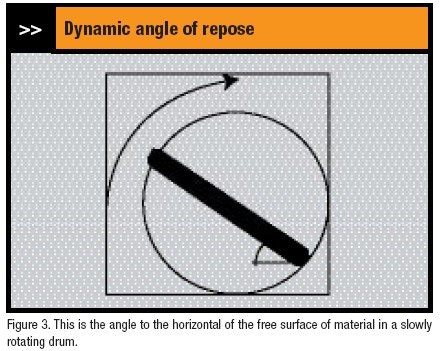

Angle of repose
Another parameter that is used to determine flowability is the angle of repose, which is defined as the angle of the free surface of a heap of particulate material to the horizontal plane. Unfortunately, we are faced with the same problem that we were with bulk density — the angle of repose is not a constant for a given material and depends upon the method of heap formation. There again are two measurements commonly quoted: the poured angle of repose and the drained angle of repose. The poured angle of repose is the angle measured from a heap formed by pouring material on to a flat horizontal surface (Figure 1). The drained angle of repose is the angle measured on the internal conical face that has been formed when material is drained from a orifice on the flat horizontal bottom of a container (Figure 2). A third angle of repose that you may come across is the dynamic angle of repose, which is the angle to the horizontal of the free surface formed in a relatively slowly rotating drum (Figure 3).
Be aware of several things when using angles of repose: First, the angle formed will depend upon the details of the formation process. For example, the fall height for the poured angle or the orifice size for the drained angle will influence the angle. Therefore, the angle measured is not independent of the measuring apparatus. Second, the same material tested using the three techniques will give a different angle for each (Table 2). The measurements only can be reliably made when using powders that are free-flowing to slightly cohesive and are fairly homogenous. Materials that are a mixture of components or that have a wide size distribution will give angles that are difficult to determine and suffer low repeatability. There also are some uncertainties based on the fundamental physics of the problem, relating to stress history and avalanche behavior [2, 3].

Despite these difficulties, the angle of repose in whatever form can be a useful tool to rank materials. As a rough guide, the relationship between the angle of repose and flowability often follows the structure below:
Angle of repose, degrees  Flowability
25-30     very free-flowing
30-38     free-flowing
38-45     fair flowing
45-55     cohesive
>55     very cohesive
This classification allows us to make some judgement on the likely flow behavior of a material but has very limited value for equipment selection and design. In particular, it is a mistake to use the angle of repose in an estimate of the wall angle required for the converging section of a hopper. However, the angle of repose can serve in some cases to estimate the surcharge (the material at the top of a hopper which forms a “heap”) in a storage vessel or the ground area requirements when forming a stockpile.
