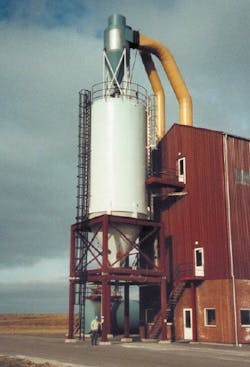

Start with the tank
First things first, a weighing application will never be successful without proper attention to the tank. Vessels are usually designed to safely hold a quantity of material accounting for such factors as wind, earthquakes and other forces of nature. The idea that the vessel will need to weigh a material is generally an afterthought in its design.

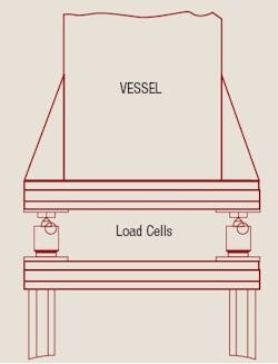

The most important factor to consider when designing for a weigh cell is the construction of the “weighing frame.” The frame is where the load cells will be mounted. Whether the cell is a shear beam, bending beam or compression type does not matter. This structural steel is mechanically connected to all the load cells under the vessel to ensure that they cannot move in different directions independently of each other. Because we’re only interested in vertical compression forces the design must resist external forces that could cause the load cells to tilt.
Figure 2 shows the best type of installation. Notice how the load cells are placed in the middle of the beams. Each cell is situated between two frames. This frame network ensures the load cells will move together, creating a more repeatable weighing environment.
Figure 2. Constructing a rigid frame is critical for repeatable weighing.
In Figure 2 the load cells are mounted on top of a bottom frame assembly that provides a rigid foundation. The weight of the vessel is being transferred to the load cells and then to the bottom frame. This transfer of force occurs with minimal deflection. Although the load cells can be mounted directly to the floor without the bottom frame, the floor must allow little deflection and settling. The load cells are measuring deflection down to thousands of a millimeter, so if your foundation deflects, you aren’t going to achieve acceptable accuracy. Most architectural designs allow a floor deflection that would be unacceptable for weigh cell operation.

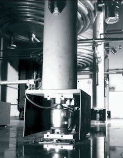

Once you ensure that your tank is  properly designed and all pipe connections are flexible, the next step is to select the correct weighing system. Although shear beams and bending beams can be used, I suggest compression-type load cells. Unlike shear-beam or bending beam, compression load cells are designed to eliminate the introduction of non-vertical loads. This is accomplished by carefully engineering a curved top and bottom. These rounded components allow the cells to “right” themselves during side loading by a principle of restoring forces (Figure 5).
Figure 5. Heat shield protects a 20,000 kg compression load cell and mounting hardware.
