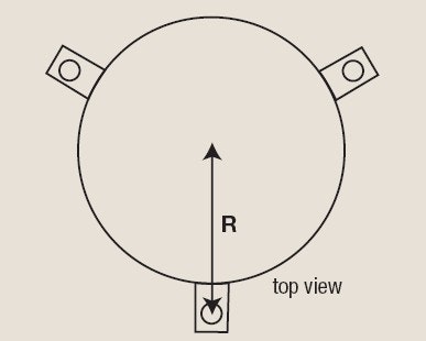

Let’s consider one final issue: thermal expansion of the tank. Thermal expansion and contraction occurs for a variety of different reasons, the most common being: jacket heating or cooling, environmental or diurnal temperature changes, and the addition of hot or cold fluids to the vessel. Were a shear beam or bending beam to be used there would be no physical way to prevent vessel expansion or contraction from inducing a load on the cells.
For example, with this type of installation, heating would cause the vessel walls to press outward on the load cells. Stress would create a force vector in the downward direction, registering as a weight change on the cells. This expansion will cause drastic, unrepeatable, weight changes from a few pounds or kilograms up to hundreds of kilograms.
Consider Figure 8, a stainless steel vessel of AISI304/1.4301 material.
Figure 8. A 230°C temperature change causes a significant change in the weigh cell reading.
The weigh system is calibrated under ambient conditions (20°C) but operated at a temperature of 250°C when the jacket heating system is running. The engineering calculations are presented below:
Radius of the tank (R) = 1.25 m
Expansion coefficient (k) = 1.6 mm/m/100°K (different depending on material!)
Temperature Difference = 250°C – 20°C = 230°C
Strain (ΣT) = 1.6mm/m × 230°C/100°K = 3.68 mm/m
Expansion of the radius = 1.25 meters × 3.68 mm/m = 4.6 mm
The expansion of the tank 4.6 mm in a shear beam weighing applications will produce severe weighing errors. Compression load cells are not physically bolted to the floor, but rather are floating and allowed to shift slightly when the tank expands. This type of cell, if properly installed, avoids the inaccuracies of thermal expansion.
