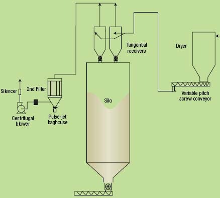

A corrosive material is transported by vacuum pneumatic conveyor from a dryer to a silo. The condition at the discharge of the dryer is about 90°F with 75% relative humidity. Since commissioning, during the summer, the blower has suffered reliability problems: seal corrosion, bearing failure, motor trips and noisy operation. In particular, bearing failure has been the main problem with this blower. Failures are worse in the fall and winter than in the summer. Current readings on the blower tend to increase slightly during the winter but the draw seems normal until sudden failure of the seals or bearings. What is the likely cause and what can we do to reduce reliability problems?

During the winter months, as the air and product progress through the system the temperature drops appreciably. If the air starts out from the bottom of the dryer at 90°F and 75% relative humidity, by the time it gets past the silo its temperature has probably dropped and hence the relative humidity has increased. At some point the humidity begins to condense and dissolve some of the corrosive. This now corrosive water is being deposited on the fan and bearings causing them to fail. The high humidity also would increase the pressure drop across the bag house, resulting in the slight increase in current during winter. The corrosive water wouldn’t be stopped by either the bag house or by the second filter; in fact, it would probably become more concentrated as it passed through the cake.
The solution would be to reduce the relative humidity at the dryer, reduce the relative humidity and condensation in the system or get the fan out of the path. We could reduce the condensation by insulating all of the piping and equipment between the dryer and the blower. If needed, we could add an air pre-heater where the air enters the system at the outlet of the dryer. We may need to add some heat tracing, depending on ambient conditions. Alternatively, we could construct a heated enclosure over the entire process.
To get the fan out of the path of the condensate we could use a pressurized pneumatic transport system rather than a vacuum transport system.

The bearing failures make me believe that there are static electricity charges being dissipated through the blower bearings. As the static electricity current arcs through the bearings the bearing surfaces become pitted. After just a few minutes of service time under these conditions an early failure for these bearings is imminent.
When material is vacuum conveyed there are static electrical charges built up. There should be a system to dissipate these static electricity charges other than through the blower bearings. An examination of the vacuum conveyor system should be made to look for the possibility that the static electricity charges are being dissipated through the blower bearings.

The problem appears to be blower failure. The cause may be bearings or seal failure. A possible solution may be identified through research:
- Seal improvement to a more-corrosion-resistant product more compatible with the conveyed material.
 - Using sealed bearings on the blower or using autolubers on the blower fan bearings.
 - Reconfiguring the blower so the bearings aren’t exposed to the air stream in contact with the conveyed material.
 - Keeping the blower seals and bearings at a slightly elevated temperature to prevent thermal expansion, which may have led to seal failures.

Consider changing the blower to a completely plastic design, including Teflon coated bearings and/or Kevlar. Use neoprene seals. This should avoid corrosion, noise and moisture adsorption.

Probable root causes are:
- air leakage in the system due to vacuum conveying;
 - at lower temperature, acid condensation; and
 - selection of materials of construction.
It seems to be the case of acid getting condensed and damaging the seal and then bearings. Higher friction leads to noisy operation and higher current consumption due to higher mechanical losses. Is there any powder carryover through the pulse jet bag house? It can lead to imbalance of rotor and sudden failure.
Recommended remedial actions are:
- choice of a more suitable material of construction for bearings and seal, if possible;
 - selection of bag specification or proper installation/maintenance of the bags in the housing to avoid powder carry-over, if any; and
 - use of some type of heater at the air intake, particularly in fall and winter, to avoid condensation of corrosive liquid.

Assuming that the fall and winter exterior air temperatures are significantly below the dew point of the air from the dryer discharge, then condensation is the likely culprit. A corrosive material plus water is a nice pair to corrode seals and bearings. The higher amp draw during the cooler months is indicative of denser air.
