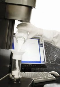

Figure 1.  Powder Rheometer: This device can
characterize powders in compacted and other states
that simulate process conditions.
Characterizing PowdersA powder rheometer (Figure 1) can serve as an excellent starting point to investigate process behavior. It determines the energy required to make a sample flow by measuring the force/torque acting on a blade rotating through the material [1]. Conditioning, which is a gentle agitation step that produces a homogeneous, loosely packed bed prior to measurement, ensures excellent reproducibility. This makes powder rheometry highly differentiating. It can measure powders in a compacted, conditioned, aerated and even fluidized state, to more accurately simulate process conditions. Modern rheometers not only provide dynamic measurement but also shear and bulk property testing capabilities. It’s therefore possible, using just a single instrument, to gather a comprehensive set of data in a reasonably short time. This encourages the development of databases of powder properties that can include: • flowability parameters such as Basic Flow Energy (BFE) and Specific Energy (SE) [1];• shear properties, e.g., yield locus, unconfined yield stress (compression strength), cohesion and internal angle of friction; and• bulk properties like bulk density, compressibility and permeability. In addition, investigating specific aspects of powder behavior such as de-aeration, segregation, caking and the effect of moisture and attrition can improve understanding. Using this database of properties, it’s possible to relate process behavior to the characteristics of the powder. It also becomes feasible to identify those variables that critically impact performance, as the following case study illustrates. Changing FeedstockA manufacturer wants to consider other suppliers for a powder feed. The operational team strongly resists, though, because feedstock has been switched before and productivity was severely compromised. The powder flow through the plant, particularly from the feed hoppers, now is easily maintained; it was erratic with the alternative material and blockages were common. In this case, the manufacturer is paying for material with superior handling performance — but there’s limited understanding of the properties that confer this superiority. Better understanding could have predicted failure of the alternative feed. So, the starting point for assuring a new feed is acceptable is to develop a specification that defines the existing material’s success. Unless this can be done, the manufacturer is stuck with the current supplier. Analysis of the current feed provides data that can be used to understand why it behaves well in the process. For example, the powder may have relatively low cohesion and a low compaction index (CI). A low CI means that flow energy is relatively unaffected by the application of a consolidating pressure. In a hopper, exiting material is compressed by the weight of the powder above it. Under such conditions, this powder won’t form a bridge blocking the hopper outlet and will tend to flow relatively easily. The measured data, therefore, offer insights on why this material may be so easy to handle. Comparing this material’s properties with those of the alternative feed that proved problematic, of course, would be even more illuminating. Such an analysis might confirm that the feed should have low cohesivity and low CI — and also may indicate that it mustn’t be prone to segregation. Specifying acceptable values for these parameters and testing prospective materials against these criteria would give some assurance of success. Using Powder PropertiesThe previous example illustrates two ways in which powder characterization data can be used. One approach is to comprehensively measure the powder and then look at all the properties to see how well the material fits with the demands of the process. For example, consider die filling, where powder is used to fill a specific volume of defined shape. Ideally the powder should flow freely into the die, settle and then flow into the required shape as filling proceeds. In this case, logic would suggest that flow behavior under compacting and unconfined conditions will be important. The way in which the powder releases air also has a bearing. A powder with low permeability may trap air, compromising filling or the effectiveness of any subsequent compression step. So, a powder that releases air easily is preferable from this point of view — however, such powders can quickly become immobile because air lubricates powder flow. Achieving optimal performance requires balancing these effects.
