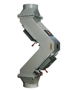

Dry free-flowing granular-type product. If material is small and free-flowing, a grate magnet provides the best opportunity for the ferrous contamination to contact the magnet directly. Grates (Figure 1) used in vertical product flows are easily cleaned, while plate magnets will work well if the material is cascading down an angled chute. Cleaning requires stopping product flow to remove collected iron from the magnet.
Magnetic Hump
Figure 3. Unit suits less-than-free-flowing materials that will cascade down a chute.
A magnetic hump (Figure 2) or radial field cartridge generally is best for decontaminating pneumatically conveyed free-flowing material. These units also require interruption of product flow for cleaning.
