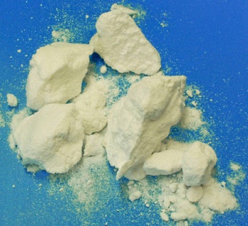

However, logistics often require storing materials for extended periods. This, in turn, can lead some powders to cake due to prolonged and undisturbed particle/particle interactions. Such caking (Figure 1) can significantly limit the ability of a powder to pass through the process train without interruption as well as negatively impact product quality.
Caked Material
Figure 1. Particles that clump together can make processing difficult and undermine product quality. Source: Freeman Technology.
