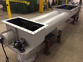

Because converting the entire hopper to mass flow would have been expensive, Ajax proposed replacing a 2-m-deep bottom section of the hopper with a vee-shaped section to exploit plane flow benefits and a large outlet fitted with a twin-screw feeder of special extraction geometry (Figure 2) to draw from the full width and length of the new hopper bottom. Another proposed alteration was incorporating a flow insert to enhance de-aeration and extend the flow benefits into the unaltered higher region of the hopper. These changes would result in a more-even residence time of the contents and a large reduction in the flow velocity (spread over a wider area) to further favor de-aeration. Moreover, the minimal plant modifications would ensure reliable operating performance.
Twin-Screw Feeder
Figure 2. Unit features special extraction geometry and draws from the full width and length of the new hopper bottom.
It only took five months from quote to delivery and installation of the equipment in Egypt.
A careful re-commissioning process was enabled progressively assessing each section of the retrofit. The changes resulted in steady and reliable flow without arching or flushing and created a consistent feed stream for subsequent plant operations.
A large proportion of the previously static hopper contents now flows during discharge. A further benefit of fitting the insert is that it prevents a direct flow path and forces material to draw from the peripheral areas near the walls with even shallower wall angles than required for a conventional mass-flow hopper. This results in increased working storage capacity and a more-uniform residence time and stable reliable flow. Indeed, the feed rate variation has decreased from more than 30% before the modifications to better than 0.5%. This means that the acidulation process can be carried out properly.
