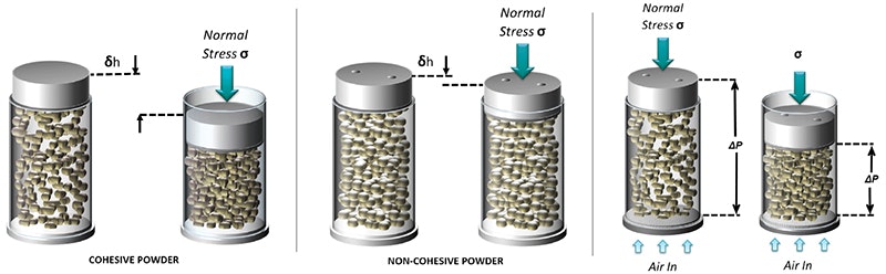

Compressibility. This quantifies the change in volume that a powder exhibits when subject to a consolidating stress; it is determined by measuring bulk powder density as a function of applied normal stress (Figure 1 left and middle). Although more-cohesive powders generally are more-compressible than more-free-flowing materials, the PCA analysis highlighted compressibility as a unique variable, essentially uncorrelated with any other measured parameter.
Permeability. A measure of a powder’s resistance to air flow, it is found by measuring the pressure drop across a powder bed as a function of air velocity at a defined consolidation pressure (Figure 1 right). Highly permeable powders allow air to transit easily with minimal entrainment; low permeability in contrast is associated with greater air retention. Permeability is highly relevant in transportation processes such as pneumatic conveying and hopper discharge.
Figure 1. Measurements of compressibility (top) and permeability (bottom) provide valuable insight into powder behavior.
