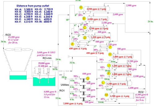

We would like to increase the cooling water flow to a tower condenser (heat exchanger A in Figure 1) from 2,900 gpm to the exchanger nameplate rating of 4,500 gpm. A review of the files shows the heat exchangers and control valves have plenty of capacity. In fact, we are concerned that so many of our heat exchangers are oversized. We’re also looking at ways to reduce the recirculation flow and pressure losses caused by the balancing orifices — we may be able to re-use the pump if we can eliminate some of this flow and the pressure losses caused by the balancing orifices. Do you think we can increase heat exchanger A to its nominal flow rate? What will this entail? Will this affect the best operating point of the pump? Do we really need the balancing orifices?
Refinery Cooling Water System
Figure 1. Plant wants to increase flow to top heat exchanger (A) to rated flow.
