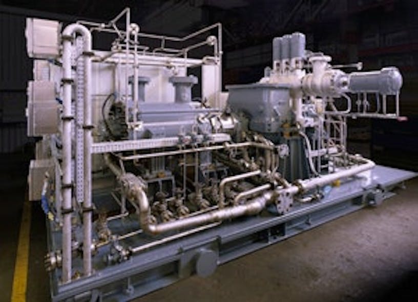

AUXILIARIES
Figure 1. A turbo-compressor usually requires extensive auxiliaries. Source: Siemens.
Figure 1 shows extensive auxiliaries for a modern turbo-compressor at a chemical processing plant. Coupling selection. Usually, the potential exists for torsional resonance and, thus, torsional fatigue failure. The coupling is the best available means to modify and tune the system. Options include: • a high-torsional-stiffness coupling (optimum if allowed by the torsional analysis);• a direct forged-flanged rigid connection (no coupling), if permitted by alignment procedure(s); and• a flexible coupling (which can provide more elasticity and dampening but at the cost of more maintenance). Torsional vibration problems continue to occur in turbo-compressor trains. The main reasons are: • lack of comprehensive torsional vibration analysis;• improper application (mainly of flexible couplings);• insufficient maintenance; and• lack of proper monitoring. As a rule of thumb, for shafts coupled together the electric motor’s shaft diameter should equal or exceed that of the turbo-compressor or the gear unit. (The turbo-compressor or gear unit shaft usually is fabricated from a higher grade material than the electric motor shaft.)Figure 2 shows some examples of couplings. Piping and auxiliary vessels. Adequately dealing with thermal expansion of piping often requires adding flexibility to the piping system, which conflicts with the need for more support and greater stiffness to reduce vibration. So, the same party should perform the turbo-compressor piping analyses, to best assess tradeoffs to achieve an optimized system. The piping configuration and spacing should ensure that expanding lines don’t touch adjacent ones or other components.During the early stage of the piping layout design, I recommend: • minimizing the points (such as elbows, tees, size reducers and the like)that can generate shaking forces in the piping; and• providing extra supports near concentrated masses.

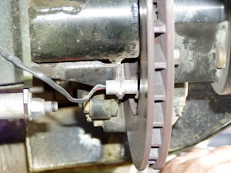

SENSOR
Figure 3. Adequately monitoring the condition of a turbo-machine can provide significant benefits.
