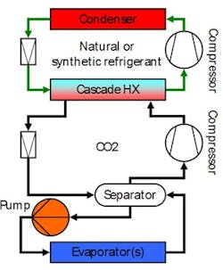

Cascade System
Figure 3. This design suits applications requiring low-temperature-level refrigeration.

2. Cascade system. CO2 is the refrigerant in the lower-stage part of a two-stage system. This type of system typically appeals where there's a demand for refrigeration at a low temperature level (e.g., in process plants) or at two temperature levels (e.g., in supermarkets). Such a system can also reduce the charge of the primary (upper-stage) refrigerant considerably.

Figures 2 to 4 show examples of design principles for these types of systems. The indirect system requires refrigerant pumps for circulation of the liquid CO2 to all the evaporators in the pipe network. In both the cascade and transcritical systems, refrigerant pumps can establish refrigerant circulation to all the evaporators in the pipe network but aren't absolutely necessary -- in some system designs internal pressure differences can also be used to circulate the refrigerant. However, pumps often are preferred because they allow liquid overfeed operation of the evaporators.
Most refrigerant pumps are used to establish liquid distribution of the refrigerant in the evaporators' pipe network (Figure 5). Such pumps also serve for liquid pressure boosting -- to provide extra pressure differential for expansion valves and to enable energy efficient system operation with low condensing temperatures during cold ambient conditions in winter (Figure 6). In larger industrial refrigeration systems, the pumps also handle general liquid transport between components like receivers and separators at different temperature levels (Figure 7).
