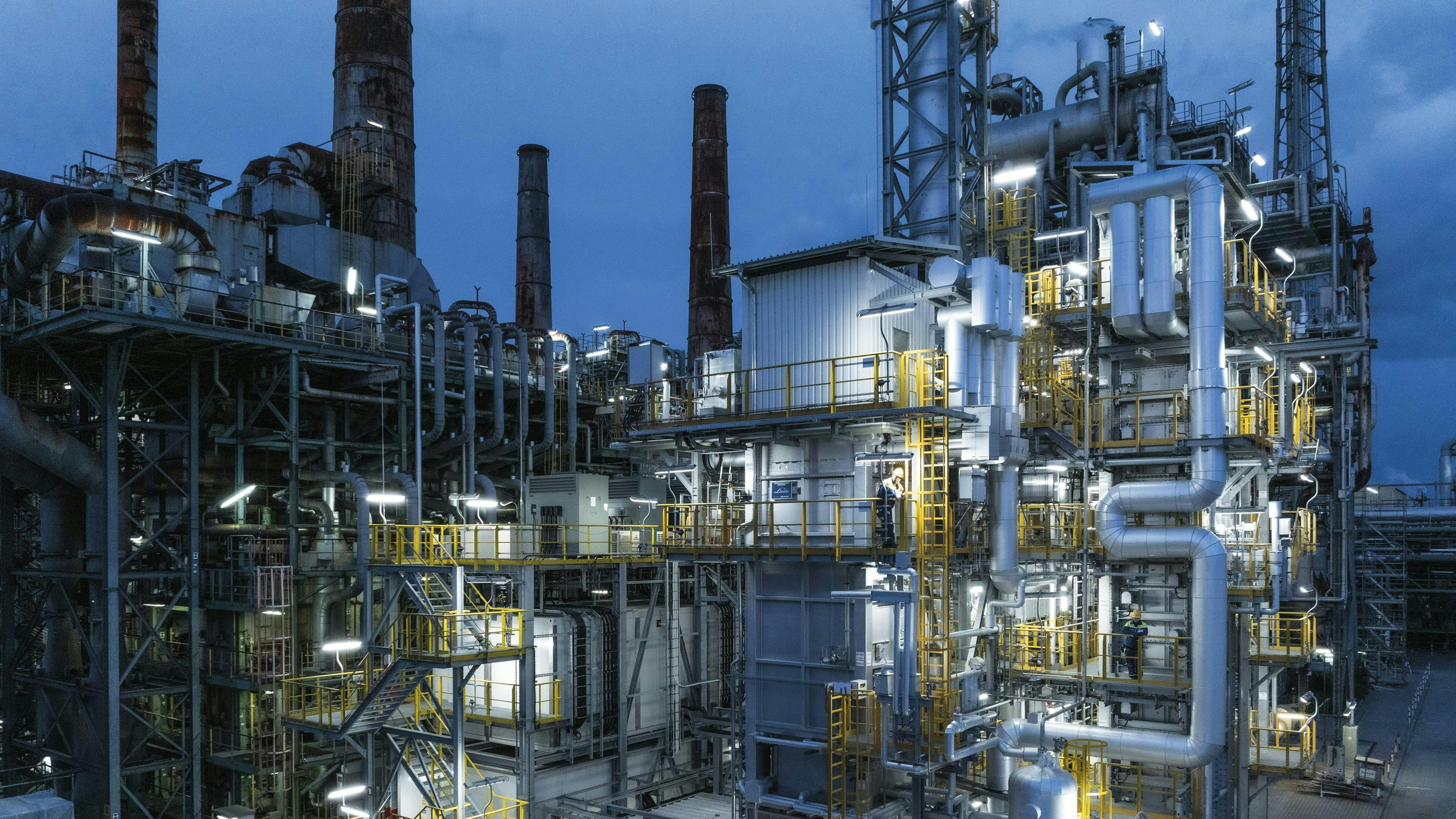

For example, three years after initially being proposed, the world’s first large-scale electrically heated steam cracking furnace – known as eFurnace - has been commissioned at BASF’s headquarters in Ludwigshafen, Germany.
A joint project involving BASF, Linde and SABIC, the challenge has been to reach and maintain a constant furnace reaction temperature of around 850°C using electricity from renewable sources rather than natural gas.
According to EU figures, steam cracking is the most energy-consuming process in the chemical industry, and globally it uses about 8% of the sector’s total primary energy. Improving energy efficiency has an immediate payout as energy costs account for roughly 70% of the net production costs in typical ethane- or naphtha-based olefin plants.
By using electricity from renewable sources instead of natural gas, the new technology also has the potential to reduce carbon dioxide emissions by at least 90%.
The prototype demonstration plant is fully integrated into the existing steam crackers at Ludwigshafen (Figure 1) and capable of producing ethylene, propylene and higher olefins from the saturated hydrocarbon feedstock.
The project now moves into its next phase, which will involve gathering data and experience about material behavior and processes under commercial operating conditions.
