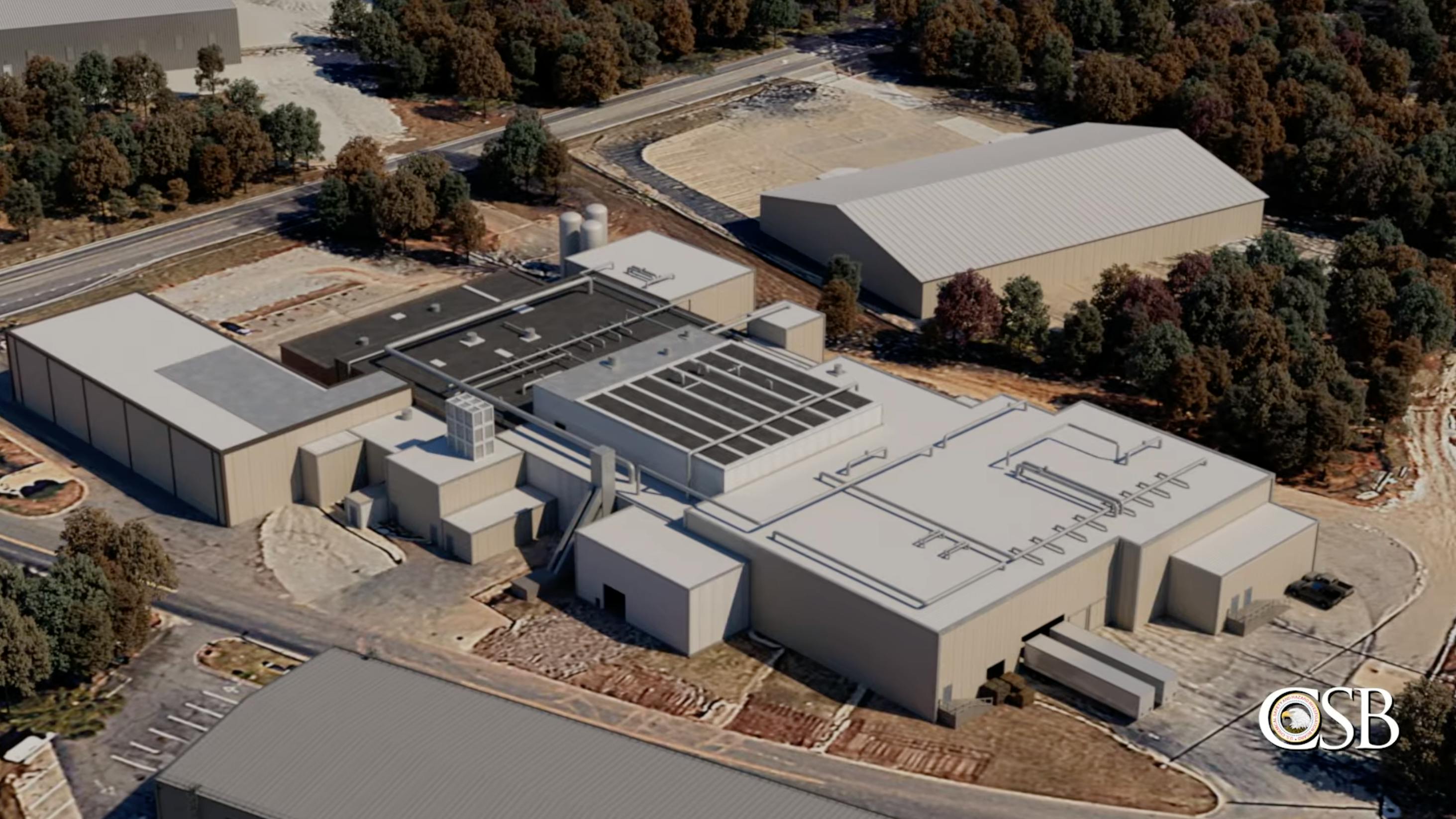

The U.S. Chemical Safety and Hazard Investigation Board (CSB) has released a safety video examining the January 2021 liquid nitrogen release at the Foundation Food Group (FFG) poultry processing plant in Gainesville, Georgia, that killed six workers and seriously injured three others.
According to the CSB, the incident occurred when a bent bubbler tube caused an immersion freezer's level-control system to continue adding liquid nitrogen after the freezer had reached its capacity. The excess nitrogen overflowed and rapidly vaporized, creating a hazardous atmosphere in the poorly ventilated freezer room.
Two maintenance workers inside the room were asphyxiated. Four additional employees died after entering the room during the response, and three others were seriously injured. The vapor cloud reportedly remained in the room for more than an hour.
The freezer was installed by Messer LLC about five weeks before the incident. According to the CSB, FFG had experienced operational problems with the equipment and Messer had made multiple visits to troubleshoot the issues.
The new video uses animation to reconstruct the incident and includes commentary from CSB Board Member Sylvia Johnson and agency investigators. The video revisits five safety issues identified in the CSB's final report: a single point of failure, atmospheric monitoring and alarms, emergency preparedness, process safety management and product stewardship.
The CSB found that FFG did not have an atmospheric monitoring and alarm system that could have alerted workers to hazardous conditions in the freezer room. The agency also found that FFG lacked an effective emergency response plan for a liquid nitrogen release and had not adequately trained employees on responding to such an event.
