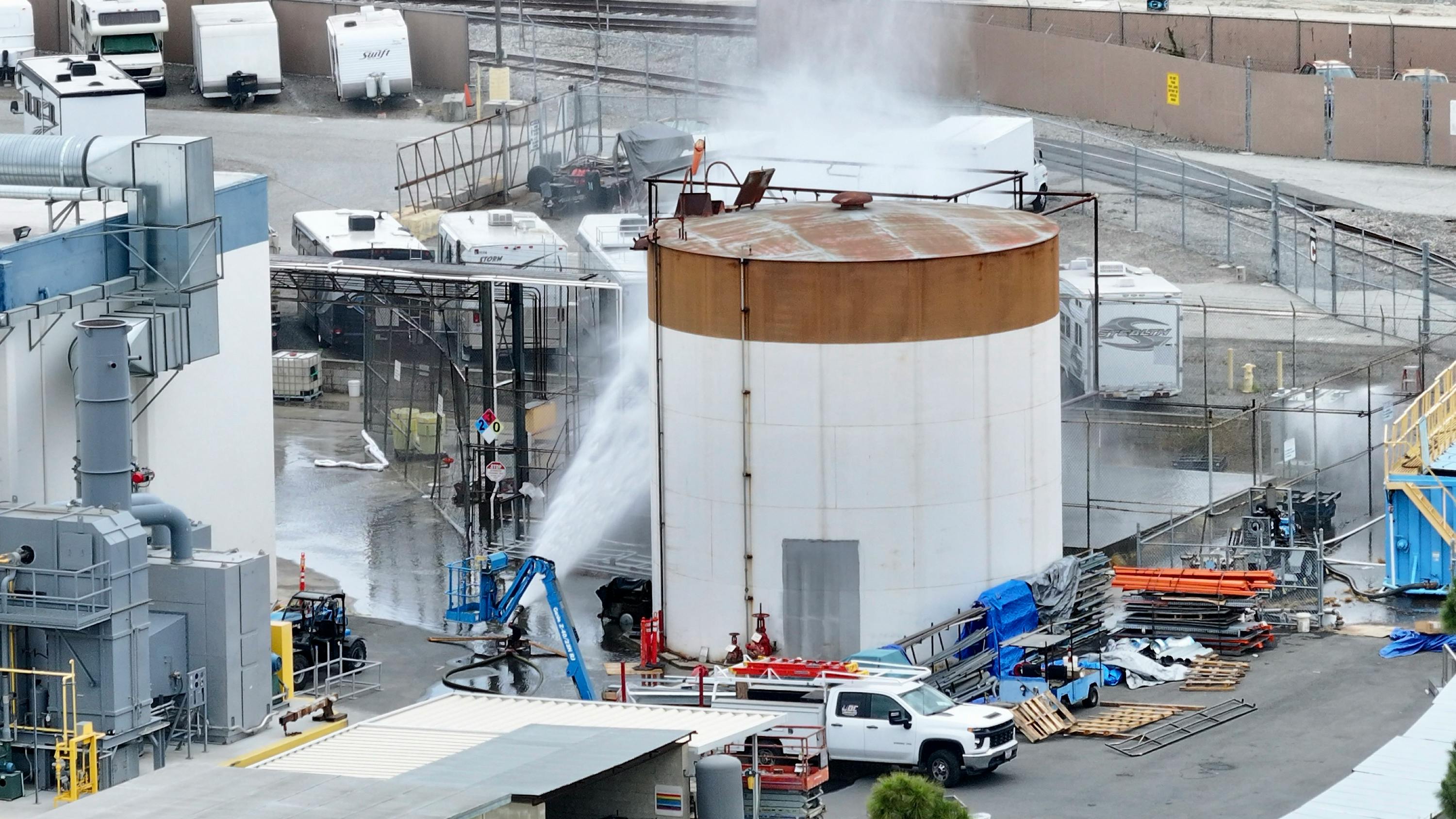

SANTA ANA, Cailf. — Crews have confirmed that a crack inside a malfunctioning chemical tank at a Garden Grove aerospace plant is indeed reducing pressure inside the container, leading fire officials to say they have turned a corner in heading off the most catastrophic threat — a massive explosion.
Data collected from an “all-night mission” by fire crews determined that the threat of a highly destructive blast known as a “boiling liquid expanding vapor explosion,” or “BLEVE,” has been eliminated, interim Orange County Fire Authority Chief TJ McGovern announced in a Monday morning, May 25, video update.
“The crack is there,” Division Chief Craig Covey added. “We had identified it is there, and the tank has released it pressure.”
After days of often dire warnings by fire officials and experts, the Monday morning announcement was the most optimistic update yet by those working to head off a potential disaster. A boiling liquid expanding vapor explosion — which would have likely caused massive damage and released a toxic chemical plume into the air — occurs when a sealed, pressurized container holding a liquid chemical ruptures.
“The threat of a BLEVE is off the table,” McGovern said. “That threat has been eliminated.”
The temperature inside the tank has also gone down, from at least 100 degrees to 93 degrees, the chief said. That is a key metric: At a high enough temperature, the chemical process was at risk of accelerating out of control — which could lead to a massive explosion.
Addressing concerns from some in the community about the lack of regular updates on that internal tank temperature, Covey said that authorities had been allowing the tank to “settle” during the warmer hours and then sending crews in to check on it during the cooler overnight hours.
“We were not doing tank temperature checks during the day when the sun was on it in the most extreme conditions for that tank to go in the wrong direction,” the division chief said. “We were only doing tank temperature checks at night.”

When they first arrived at GKN Aerospace on Western Avenue on Thursday, fire crews were told by a project manager that there was nothing they could do: A tank filled with 7,000 gallons of methyl methacrylate, a highly flammable chemical, was going to fail, either spilling and sending the chemicals pouring into a parking lot or exploding with a fireball that would send a plume of chemicals into the wind.
“For a first responder to hear that there’s no options is unacceptable,” McGovern said in the interview. “We knew we had to come up with options, solutions. That’s what we do.”
While fire officials publicly warned of the likelihood of an explosion or leak, they also began troubleshooting with a group of experts, including specialists with ties to Los Angeles, San Bernardino and Long Beach.
Gummed up valves and concerns that drilling into the tank may spark a reaction with the volatile chemicals seemed to rule out obvious solutions. But a continued water deluge of the tank appeared to keep an explosion or leak at bay, giving the experts time to craft potential out-of-the-box solutions.
“We developed a think tank,” McGovern said. “These gentlemen got into a room and started developing options. That was a success. These are unprecedented issues.”
The current goal is to keep lowering the temperature of the tank, down to the 50-60 degrees, in order to stabilize the situation and put some of those solutions the experts have been crafting into play.
Crews and chemical experts — at their own personal risk — have carried out the overnight operations to get a first-hand assessment of the compromised tank. That led to the discovery — overnight on Saturday — of the crack at the top of the tank.
They don’t know if it is a new crack, or one that previously existed. Since it is at the top of the tank, the crack has not yet resulted in any chemicals leaking out.
The crews went back in on Sunday night, McGovern said, and confirmed the crack was releasing pressure.
Then, the chief said, they began removing some of the outside skin of the tank and the insulation around it. Those layers were keeping the temperature inside the tank high, despite the cooling water crews were spraying it down with.
Once the water was directly hitting the tank, the temperature started to fall.
“What we found was the internal temperature started dropping,” McGovern said.
The chemical also appears to be starting to solidify, McGovern said. But that process seems to be happening from the outside in, so the current density of the center is unclear.
“We need to see the density inside,” the chief said. “It solidifies into a plastic form. We don’t know yet if all the substance has solidified.
“That’s what we believe is going on. That’s what the readings are showing,” he added. “At the end of the day — and I don’t meant today, but at the end of the day — if we open that tank up, (there’s) a big chance that it’s a big plastic pill.”
