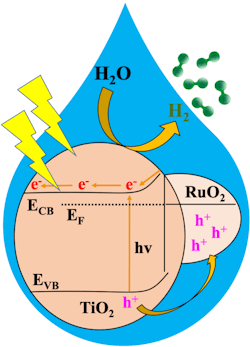

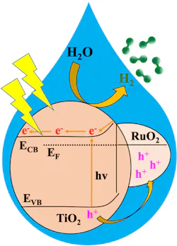

The photocatalyst, called RTTA-1, is a MOF-derived metal oxide heterojunction combining ruthenium oxide and titanium oxide doped with sulfur and nitrogen. It demonstrates remarkable efficiency in splitting water into hydrogen when exposed to sunlight. In just one hour, one gram of RTTA-1 produced over 10,700 micromoles of hydrogen, with a quantum yield of 10%.
“The remarkable activity of RTTA-1 is because of the synergistic effects of the metal oxides’ properties and surface properties from the parent MOF that enhance electron transfer,” Stylianou said. “This study highlights the potential of MOF-derived metal oxide heterojunctions as photocatalysts for practical hydrogen production, contributing to the development of sustainable and efficient energy solutions.”
