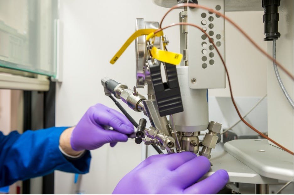

The scientists wanted to understand how a nontraditional metal catalyst on a nontraditional type of support compares with traditionally used materials during the catalytic conversion of propane (Figure 1). Catalyst support materials typically have high surface areas and help to distribute catalysts. As this research shows, they can also play an important role in promoting catalysis.
